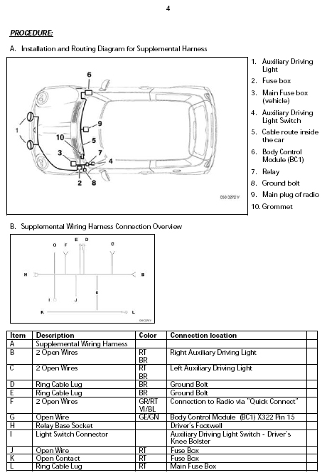

Hi,
I finished the last portion of the factory driving light install yesterday and now I have a problem - perhaps it's unrelated but that would just be some coincidence now wouldn't it?
My problem is that the airbag indicator light in the middle of the speedo is now always on.
I downloaded the factory installation instructions for the factory driving lights from minimania.com

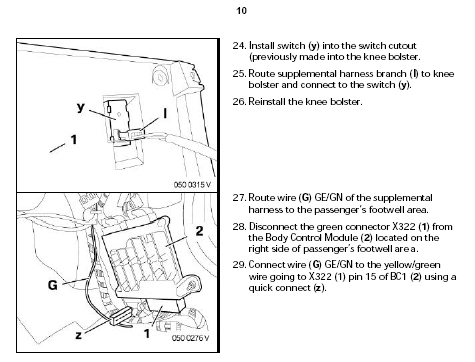

My problem revolves around the wire labelled "G" in the attached diagram from the instructions... This is the yellow/green wire that needs to be spliced into a yellow/green wire at X322 pin 15 of the BodyControl Module 1 in the passenger footwell.
When I pulled the plastic trim off to get to the Body Control Modules it looked like the plug the instructions were pointing at is the big green one at the bottom right of the BC1. I didn't see any numbering on the actual plastic plug so I went by wire color. The only one that was the right color was a slightly thicker gauge (makes sense if it's for highbeams) and was approximately in the middle of the green plug. I spliced the loose wire into that and while my factory driving lights do come on the way they are supposed to I now have the airbag light on too.
Before I spliced this wire in everything worked fine - that's why I think it's either this wire that's in the wrong place or the craziest kind of coincidence.
I did have to pull the passenger chair to get to all of this and made sure when I reinstalled it that I plugged all 4 wires that go to the underside of the chair back in... So what gives? I've unplugged them and replugged them again just to make sure.
Any ideas?
Thanks all,
-e
PS: the car is an 06 MCS. The factory driving light installation instructions are dated 2002. The latest headlight wiring diagrams I've been able to find here at the BMW/MINI design studio are labelled 2004. Does anyone know if there's been a further wiring change since then?
Anyone else install the factory lights themselves on an 06? Thanks.

Hmm that's a good point GBMINI...
Come to think of it when I pulled the seat out and disconnected the 4 wires that go to it (one of them being the airbag sensor I suppose) I believe the battery was still connected. And I also believe that before I put all the passenger side plastic sill trim & the passenger seat back in I did turn on the car and hi-beams to make sure the driving lights did work. So that's probably when it happened...
Thanks a lot GBMINI. I'll call the dealership and try to schedule something with them to try to get it cleared sometime soon.
-e
