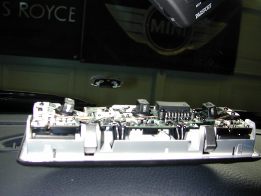

Can anyone tell me how to remove the map/cabin light assy. on a 2006 MC cabrio. I need to access the antenna.

It pops out. Put a small straight slot screwdriver in the back side of the light and gently pry it downward. There are two spring clips holding it in on the backside. The are about 1/4 way in from each corner.
Here it is removed....notice the spring tabs.
Attached Thumbnails Map/Cabin light access-lightpanel_small.jpg

Thanks for the info. It really helped.
