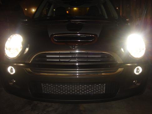

Old May 4, 2006 | 01:52 PM
Trip024's Avatar
Trip024
Joined: Dec 2005
Posts: 401
From: Socal
I love mine!! I did change the original led's as they were too blue though. They match the Xenon's almost perfectly. Heres a couple of pics
Attached Thumbnails Moss Mini riding light "angel eyes"-untitled1.jpg   Moss Mini riding light "angel eyes"-untitled.jpg

looks nice, I like how they match, you have the xenons right?

yes there xenon's
