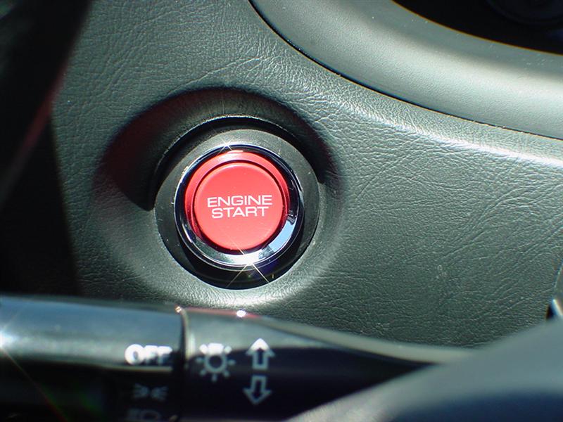

Originally Posted by 02///MCS
Does anyone know if you can get the S2000 kits sold on eBay to work without too much work?
It's actually a simple retrofit, from what I understand. I had one put in my Type R a while ago but the process is same. Just take the switch to your favorite Car Alarm/Stereo shop and have them wire it in. It wires up to a relay connected to the ignition. It's only active in the second accessory position. Mine didn't disable the key start but worked in parallel with it. I could use the key or the button to start the car (with the key in Acc2 position). I believe the OEM S2k button was around $25 and my shop charged me around $50 to wire it in and mount it. If I were to do it in the Mini, my toughest decision would be where to put it without it being to flashy/ricey. I'd probably put it on the left side of the steering colum to be a little more subtle. Hope that helps..
Happy Motoring!
