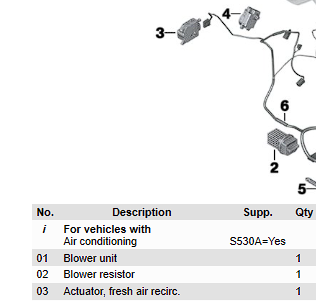

For an R58, but I think this option exists for other R5X vehicles. When I was setting the options for modules using NCS, I set the Automatic Air Recirculation Sensor, to 'Active' (defaulted beforehand to 'Inactive') because my MINI has a toggle option for Auto-Recirc. After this module programming error codes showed up on the OBDII reader as an JBE: AUC sensor error, and a D376 Error -- Also related to the AUC sensor. I coded this option back to 'Inactive.'
The long and short of my surprise is, my 2015 R58 was built to NOT include an Automatic Air Recirculation Sensor:
RealOEM.com data:
I am perplexed no how the Auto-Recirc works without a sensor. The only thing associated with the Air Recirculation in my R58 is the Air Recirculation Actuator (see below). I can reconcile how the actuator works when the Recirc option is selected by closing the HVAC to outside air but not when the Auto-Recirc option is selected.
My question: How does a vehicle without an "air quality sensor" know when to selectively open or close the air recirculation flap? My BMW X5 has a similar A-Recirc function, so I understand the functionality and utility of the Auto-Recirc feature.
For context this digital Control Panel is featured in my R58
Actuator (No Sensor) (#3) is part of my R58 configuration
