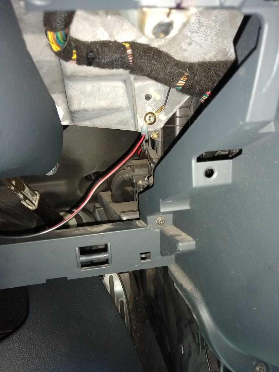

The chassis ground is located to the left of the stereo, I will be using the large torx bolt as a grounding point. Crimp on the ground wire strap and reattach the torx bolt to the same location. You can see I already had a ground strap for my hardwired dash camera, in a standard car it would be a bare screw.
