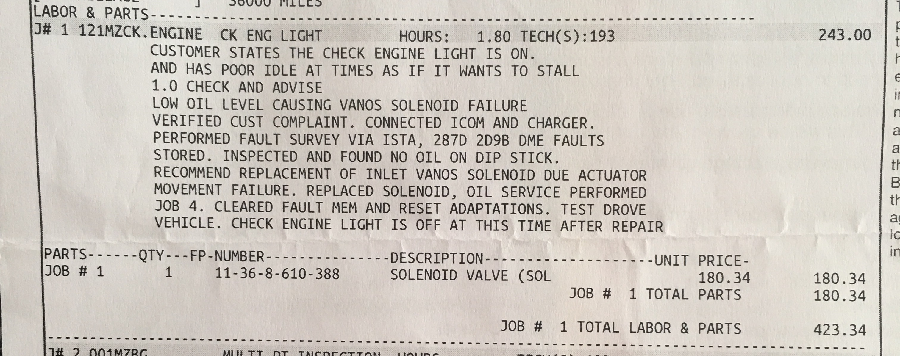

I have a 2010 Mini convertible with 69,000 miles. I don't know if it's electrical or not but wasn't sure where to start. Here's the issue I've been experiencing. I slowed down to a near stop and the car simply stalls. No strange noise, no warning lights come on, nothing. I still had access to steering and the A/C was still running and everything else seemed to be working. Fortunately I was able to coast over to the side of the road and start my car with no problem. I made it home w/o it happening again. The next day we decided to drive it to see how it was running and if any warning lights were on. No problems, no warning lights. The following day we tried it again and it stalled in the same manner as mentioned above. Again no lights came on.
A week prior to it stalling the check engine light came on. (see attachment for service record. I don't know if this has anything to do with anything. I called Mini service and explained what happened this week and asked if it had anything to do with the issue a week before. He said no and that since no warning lights came on they didn't have any place to start. He suggested bringing it in and they would test drive it to see if happened again and maybe have a place to start... That could be super expensive!
