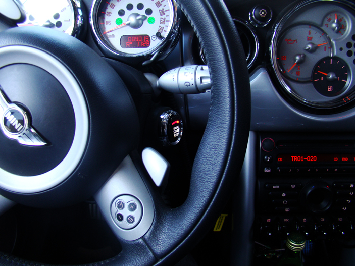

All jokes aside this would actually be a cool mod
http://secretech.wordpress.com/categ...t-stop-button/
Attached Thumbnails R53 ignition toggle switch-image-1565920186.jpg   R53 ignition toggle switch-image-1078904413.jpg
