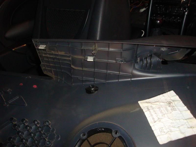

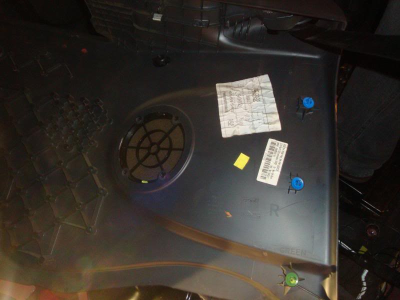

So I'll just post up my pics to augment the PDF drawings. The only difficult part is that the rubber seals next to the seatbelts are fitted with single use push pegs. You cannot extract and reuse them. Try to maneuver the rubber out of the pegs or order two new pegs.

Here you can see the fixings for the interior trim panel. Any metal clips that stay on the body, remove them and put them on the plastic for reassembly.

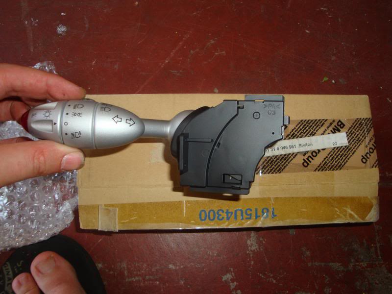

Ordered the auto lights version for my RLS retrofit.

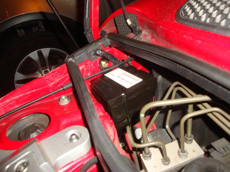

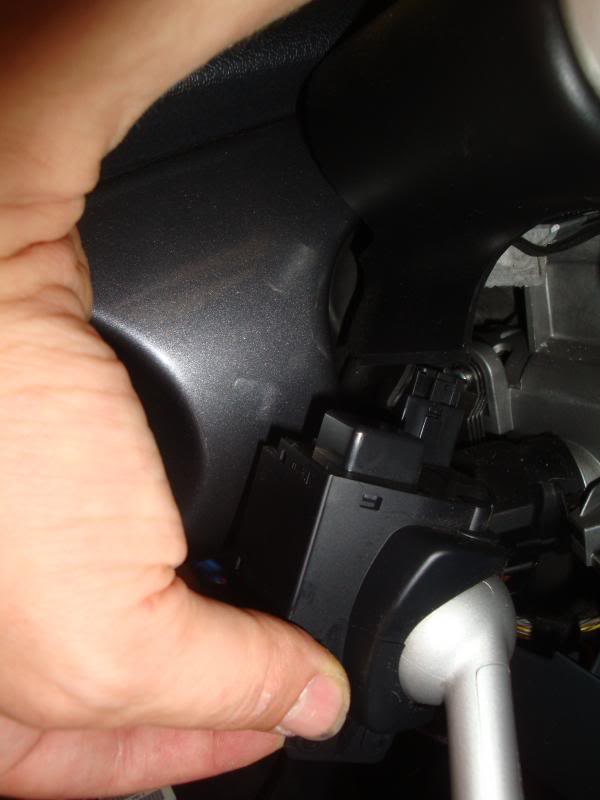

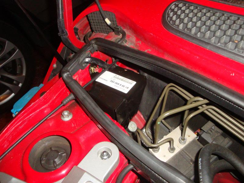

Fairly self explanatory with the PDF instructions and the harness read waiting.
Coding is required to activate the alarm.
