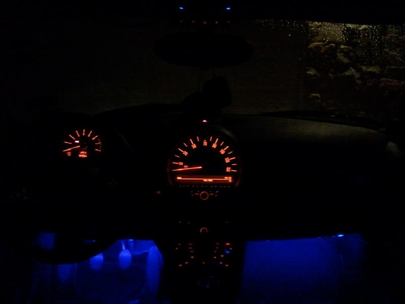

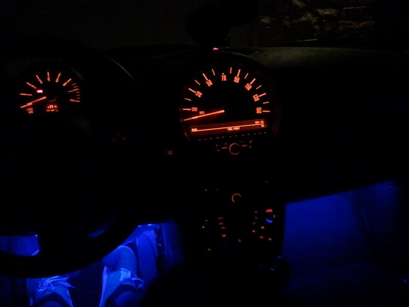

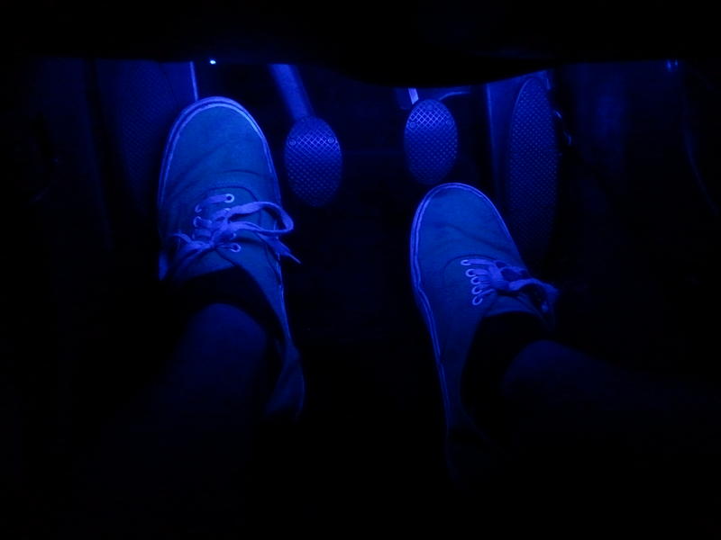

Finished:)
Thanks guys i kinda ended up taking from all of your suggestions and ended up using an add a fuse a switch and two blue led strips. all together i think it cost me about 30 dollars. I was able to find the LED's from walmart surprisingly in the auto section and i have to say they look great. they arent to distracting at night because theyre blue and there are not any laws against interior LED's that i know of in texas so i dont believe ill ever get pulled over for them.
