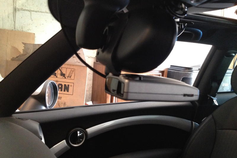

Took a few minutes today to fabricate up a mount for my radar detector. Used the visor clip, bent it to a 90 degree angle and secured it to the back of the mirror using some 3M double stick tape. I figured I'd share for others looking for another option. I then used this thread, https://www.northamericanmotoring.co...ew-mirror.html, to hardwire it up. SPLENDID!
Attached Thumbnails Radar Detector Mount and Hardwire-radarbracket1.jpg   Radar Detector Mount and Hardwire-radarbracket2.jpg   Radar Detector Mount and Hardwire-radarbracket3.jpg
