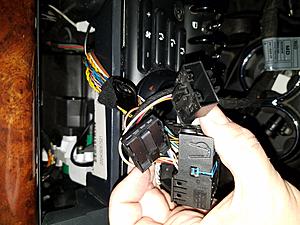

SOLVED....well, sort of.
Figured out that if I disconnect this plug (see pic) then everything works just peachy but the stereo. Not sure if it's a compromised plug or another area somewhere in the harness, but once I clip it back together it's bonkers!
Attached Thumbnails Turn Signals and Dash Control Problems-20180307_185649.jpg

I'm glad you fixed it!
Do you know what that plug is for?

It's not fixed yet. That plug makes the stereo work. Without it connected I have no stereo. I'll inspect the plug & see if I can tell where it's failing.

I had someone take a look and found it to be the stereo. It started trying to eject a cd whenever it was plugged in. I gave up and just disconnected it. Sold it before I got a new CD player. It was a great car, but I wanted something faster. Don't get me wrong, it felt fast and was fun to drive. But I figured I could buy a corvette cheaper than it would be to make the mini really fast.

Originally Posted by ghshamblin
I just want to say thanks to all on the post. I have a 2005 R53 with only a few minor engine modifications... complete exhaust system, MSD coil, 15% supercharger pulley, cold plugs and cold air intake.
I had the exact same problems many have noted...
- Turn signal not working
- Steering wheel radio controls not working
- Brake lights staying on after turning off the car
- Airbag warning light on
- Seat-belt light stays on
- Lights on gauges stayed on with lights turned off and car turned off
I had to disconnect the battery to get the brake lights to go off... reconnected and they stayed of. Started the car and all symptoms returned.
I HAD an aftermarket (DICE) iPod adapter connected to the factory radio - non-Harmon Kardon.
After removing the adapter, everything works as it should! Guess I will have to go back to CD's or an FM adapter.
My sincere thanks to all the posters here. I had the exact problems in my 06 R53 that ghshamblin listed . I took out the iPod adapter and all is well. I hadn't used it in years anyway

iPod Cable removal
Hello everyone,
I know this thread is quite old already now, but I am facing the same issues as other people have described before. Indicator on the dashboard not working, brake light stays on, etc. on my 2007 Cooper S Convertible.
Interestingly my radio also started to say „Disabled“, but only once the engine is on. When the ignition is on it still seemed to work.
Anyways I wanted to start by removing the iPod Cable since people have reported that this once is causing the issues. I already checked multiple spots for moisture but everything seemed to be dry.
I saw the instructions on how the cable is installed and it involved a lot of changes on the radio, including the crimping of cables. When people write here „They removed the cable“, did you reverse engineer the whole thing or just removed the single cable that connects to the iPod?
Thanks a lot and all the best from Germany
