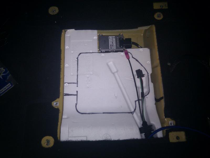

Here's a couple photos of the BT retro install. I will put together a PDF of the photos I took with some notes on my experience with the install.

Attached Thumbnails I am looking to install Bluetooth-img_0568.jpg   I am looking to install Bluetooth-img_0591.jpg   I am looking to install Bluetooth-img_0586.jpg

Got my MINI back from the dealer. They said that they tried to program the Bluetooth twice and "it would not take" Attached are some images of my CID, notice that I now have the Communications option and the bluetooth setup option. It says to turn on bluetooth, but the checkbox will not respond to joystick clicks.
The dealer said that it is most likely a problem with the install and wanted to charge my $700 to cover over my entire install. I almost said yes, but then realized that I had purchased the MULF (BT) until from a salvage dealer on eBay, and it was most likely the issue with the programming not taking.
So I am frustrated to say the least. This weekend I am going to review my entire install. More to come.
-=Ryan
PS. I know have a "High Battery Drain" Msg, and the dealer says it is due to my install. I kinda get the feeling that since I did the install, they tended to point the figure of issues at my handy work.
Attached Thumbnails I am looking to install Bluetooth-minibt_1.jpg   I am looking to install Bluetooth-minibt_3.jpg   I am looking to install Bluetooth-minibt_4.jpg

So, I pull the MULF unit out from under the driver's seat, this time WITHOUT disconnecting the yellow AirBag/Seatbelt plug thing.
I open the unit up (which I should have done before I even installed the darn thing) and it looks like it came from a mini that sat on the bottom of a lake for a few days. The circuit board had obviously been submerged in water. All the components had water damage and corrosion.
Did did re-check all my wiring, even use a flashlight to test the Fi-Optics out to make sure I did not kink one of them; all checked out, has to be this corroded circuit board in the MULF.
So I turned the car on, and now that it is programmed for the MULF unit, the radio and the rest of CID will not work unless I hook the MULF backup. The display show a message of "Loading data from... bla bla" or something. Therefore I decided to give the circuit board a bath in alcohol and used a toothbrush to try and clean it up.
I connected the MULF, minus its metal housing, and turn the ignition on, now the radio and aux in is working again and I can see a read light on the MULF board, so I which over the setup to see if I can setup bluetooth; still a no go.
Guess, I will have to pay the BMW premium and order a new MULF!
