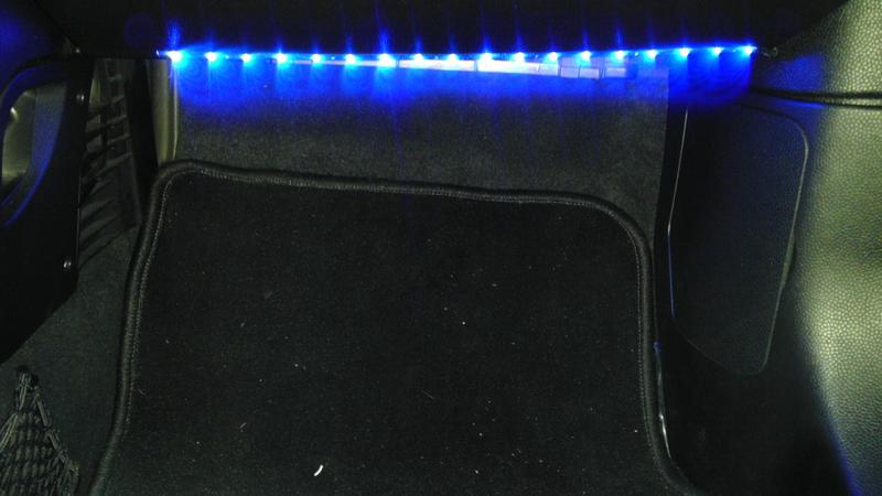

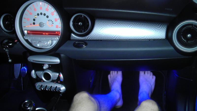

So, I wanted a little colored lighting under the dash above both of the front footwells. I like a little ambiance for my night driving, and wanted to compliment the stock interior accent lights.

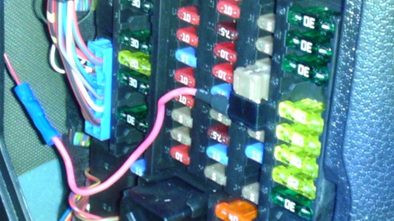

I got some cheap 3M adhesive SMD strips off of fleabay, ran the wires through the underside of the dashboard, and connected them to the only switched fuse I could find - F35.
I bought a mini "add a circuit" from Advance Auto, then got an extra 5A fuse to protect the extra circuit for the lights.
The end result is really sweet, but hard to catch on camera. They only turn on when you have the ignition switch on, and have a nice gentle glow. I used a tiny dot of superglue on each end to make sure they wouldn't peel as temperatures fluctuated.

Is that fuse box on the right or left side? Just to be sure you said F35 is a switched 12V source.... Wana use that for an aftermarket driving light set up with my our rocker switch installed on the left side of the dash.
thats on the passenger side. also, it is only "on" when the engine is running. so when the engine is not running, there is no current through that fuse
