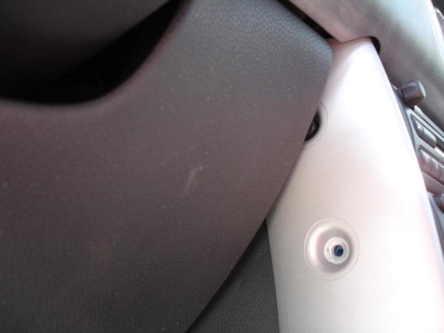

yea.. i got the screw at the knee bolster that is not accessable , and also, i cant get the Mirror/Heated seats button pice out!

heres the problem, i cant get this screw, i can get the bottome one, but not the top..

take the panel off you must tug pretty hard good luck

http://www.mini2.com/forum/faq.php?f...aq_faq_removal

SWEET!! I think that did it.. I am soo afraid to pull that thing, but here goes noting.

Thx guys GOT IT.. I am now rocking the XM thu the Aux adapter!
