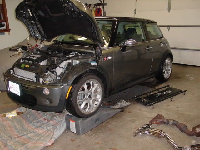

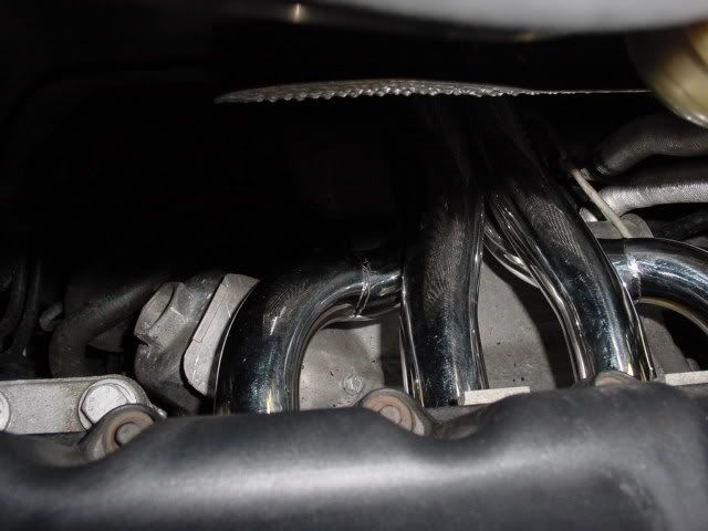

Well I got home from work tonight and ups had dropped off a package for me. It was my Alta header and a set of NGK colder plugs.
I got started right away and the wrenching began.
I took a break from working on it to eat dinner and then went out and finished it up. Took it for a ride and the first thing I noticed was she is quite a bit louder.. lol no cat, for off road use only.. Yah right.. haha
I am planning on taking it to the track this friday if the weather is good and the track is dried up from the weather from the last few days. After I got back from my little drive I changed the plugs and took it for another drive.. I really enjoy driving this car..:icon_smile:
Here are a couple pics from the install...
Bill

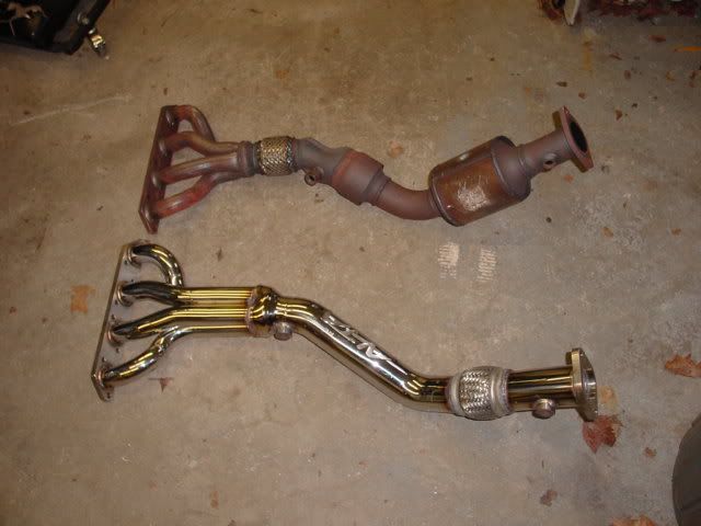

Hows that thing mate up down below? It looks like it has a different degree of bend than the stocker....

Yah it was offline by about an inch and a half, but I was able to muscle it over enough to bolt it up. Not bad all in all and the sound.........oh yah the sound... sweet sound......

It fit against the head great, I tightened all that up first with no problems. Maybe the one with the cat will have a little better bend to it..

It took me about 3 hours to do, not to bad of a job. The hardest part was starting the header on the head. Holding the gasket in place and getting a couple bolts started. after that it wasn't bad..
Bill

While I agree, where exactly would he be installing it? Notice the photo shows the catless header to be the same length as the stock header *and* cat, so unless he has a shortened cat-back system, there's no room for the cat.

Well, if he had the header you post the photo of, maybe, but look again at the header he actually installed. No flanges and no mid-pipe. Just solid welded tubing all the way to the second o2 bung...no cat here, and no where for it to go.
And I must agree again with rl.48.mini, the noise is amazing with no cat, but the performance gains are minimal at best, especially without a head (but then, which head is the Alta header designed to match with?) In the end, just a whole lot of feel-good SS near your right foot, and a whole lot of noise at the south end of a north facing Mini.
