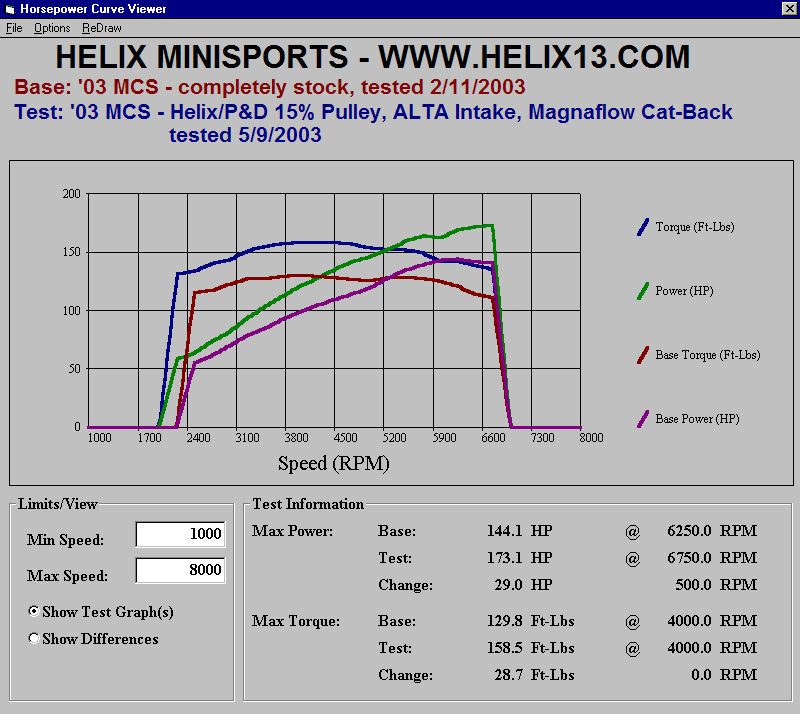

Gotta love that torque plateu

Andy what is with the dip at 6k? I notice the stock pull didn't have it did you guys do a/f this time as well...I'd be curious to see if it went a bit rich at 6k or if it pulled some timing all of a sudden.
Ok I just looked up your original graph on helix's website and I noticed that with the pulley it has that tiny dip and also on the a.f it goes a bit lean there see what I mean, maybe that chip needs a bit more reinement to prevent that dropoff

All of the above dyno plots were done with the stock chip.

Andy why did you reflash it for the stock programming? Thought you liked the higher rev limit?
