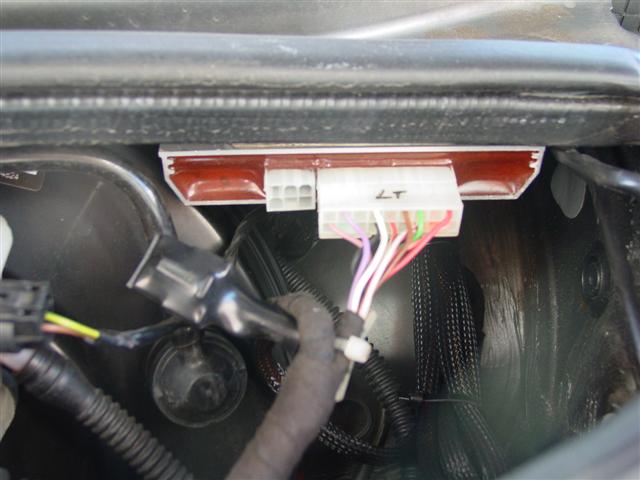

Here's a picture of what I think tricked is refering to .
Don't comment about the dirty engine bay .

yup that its, whats it for.. i guess i dont need it.
