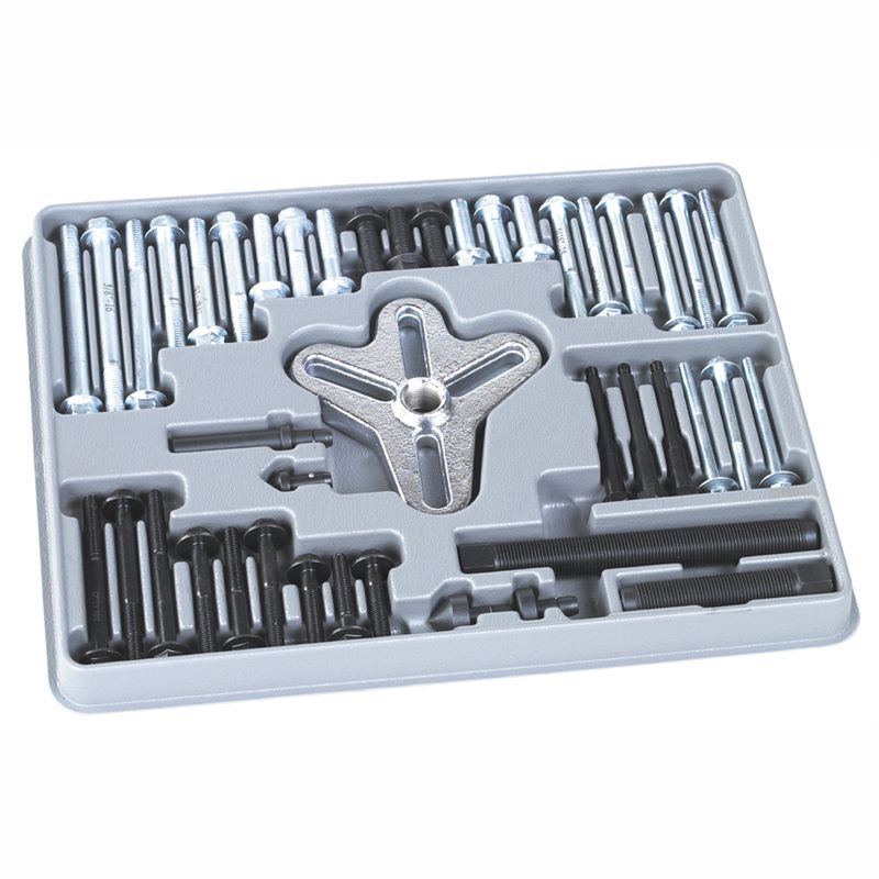

Oh boy, I wish I had all the money in the world to buy the damn BMW tools to make my life a bit easier.
You dont need the BMW tool to do it.
A harmonic balancer puller is MADE TO DO THE JOB it just doesnt say BMW on it.
This is made to do the job at hand, and its what I use whenever I do a crank pulley.
A bolt grip puller, as shown above, is a much better tool choice than a generic duck billed style puller.
The thread protector tool is still a worthwhile additon. If the old bolt is used as protection during extraction it will have to be continually backed out for clearance, which reduces the number of external threads in contact with the crank shaft risking thread damage.
