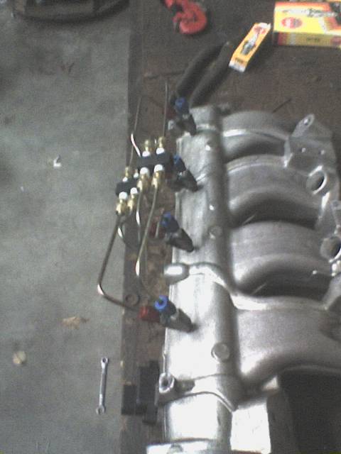

Direct port installed!
Hey guys just finished tapping out my intake manifold and bending the tubing for my new nitrous setup. Check it out...

Looks good. How big of a shot are you going to be running? 75 shot?
Old Nov 19, 2006 | 04:41 PM
spillman's Avatar
spillman
Joined: Nov 2004
Posts: 890
From: Rutherfordton, NC
Between a 100 and 200 shot. I shall see what it takes to run the times I want.

Question on the squirters...
is there any downside to having them on the manifold as opposed to the runners going to the intake vavles? The way they are placed, it looks like you could have a combo of throttle body and port injection like behaviours. But to be honest, Nitrous is all new to me so I'm just curious...
Matt
Old Nov 19, 2006 | 08:52 PM
spillman's Avatar
spillman
Joined: Nov 2004
Posts: 890
I put them as far away as I felt comfortable from the head. This lessens the abruptness of the nitrous hit. A 50 shot broke the tires loose in first gear on slicks. And that was with the nozzle on the cold intercooler horn (in supercharged form).
I don't see any problem with it. I have seen many cars with direct port installed in a similair manner.

Perhaps a progressive nitrous controller would be a good idea? Those quickly pulse the solenoids like a fuel injector to ramp up nitrous flow however you'd like.
Old Nov 19, 2006 | 09:22 PM
spillman's Avatar
spillman
Joined: Nov 2004
Posts: 890
This will not be used on the street. Strictly for the drag strip. My turbo will put out over 400whp. So I have plenty to spin third on the street. That's why I said I was running slicks. Previously when the car was twincharged it made 415whp and 400 ftlb of torque with a 50 shot.
I have a progressive controller. But I will see if it is neccesary in second gear. I may run a small shot in first to spool up the turbo... On a single nossle.
