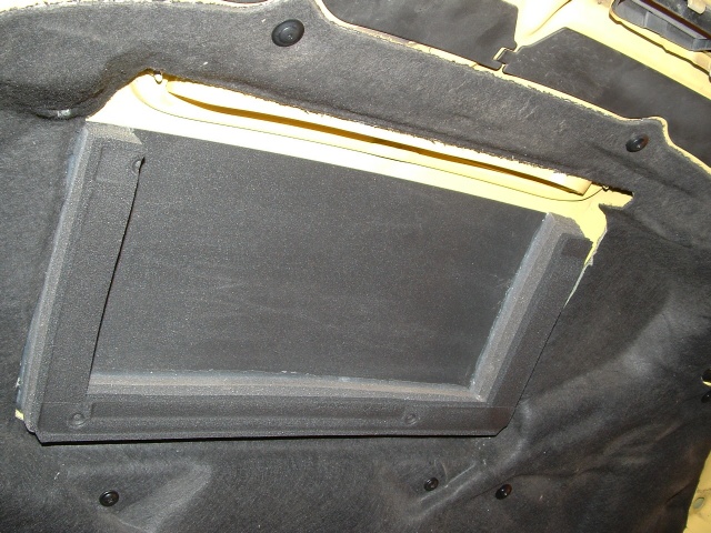

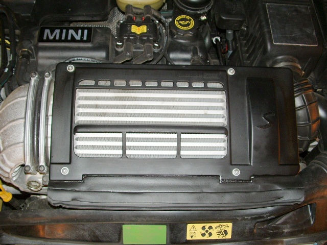

A couple of pix of my solutions to the issues created by removing the black bonnet piece and filling the gap between scoop and diverter:
- My bonnet piece is designed to seal off the back and sides of the diverter, while intruding only 1mm into the space above the IC. The black part is generic "dynamat" from McMaster-Carr. The grey foam is open-cell urethane 1-1/4" x 1-1/4", with silicone rubber masking off the 1/2" toward the bonnet.
This didn't quite contact the diverter all around, so I added a couple of layers of 3/16" x 1-1/4" closed-cell foam to build up the height.
As can be seen, it formed itself nicely to the diverter.
- The rubber piece between diverter and scoop is now about 2" wide, to fill the larger gap. The diverter shown is a do-over, now that I have the dimensions needed. The next version will be removable instead of glued on, and will be much tidier.
The rubber is garage-door weatherstrip - currrently about 5 pieces glued together as I went from the stock scoop to the M7.
An issue with this piece is that most MCS motors will rock fore and aft about an inch under load. Mine does not move nearly as much because I have a Mini-Madness urethane bushing in the lower "torque mount" in back of the engine, a mod that I highly recommend.
- The final picture is looking into the scoop - it's a BIG s-hole...

it was not really all that hard. i cut the front of the stock air seal, and bolted it back on. everything seals well and looks good. yeah there is a bit of a a hole between the scoop and intercooler, but it's not too bad. i tried to fit the stock part on the back of the scoop and it would only extend about another 3/4 inch or so. the path the air will take, looks like everything should be o.k. if you look at early 02 cars till about may 03, the cars all came with a rubber flap that hooked onto the end of that scoop seal. it laid on top of the intercooler so that there was no hole. every car from may 03 on has not had that flap. so MINI has even found it is not needed. i am sure Scott will post some of the photos of the final outcome. it looks really good on his car.
Thanks to Chad with helping me with the install
The First photo is of the Mod' Upper diverter
Chad pretty much ended up cutting a straight line. With double sided trim tape to hold the U/Div to the bonnet.

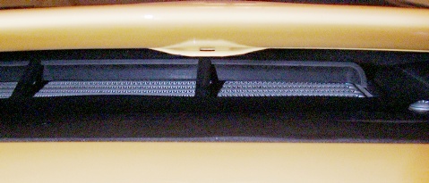

Next is a close up full frontal of "Ram Air Intake Scoop" produced by M7
Next Side view
Next 3/4 view
Next Full frontal distant (with Orciari Cowl Scoops)
As I have JCW my I/C cover is silver
Next Side view
Next 3/4 view
IMHO, any gap between the front of the IC and the bottom of the scoop will spill any ram-air effect around the IC, and render the larger scoop fairly useless, aside from bling-effect.
Mini quit sealing off the bottom-front of the scoop for lower cost, not because it works as well.
With that said, the distance from the back of the M7 scoop to the side of the I/c cover.
That has increased to about 2in from a gap of about 3/4in. With that being said when you look at the scoop head on yes you will see a lot of the I/C cover..
This is a low angle shot, this is the same angle that the air will be flowing of the bottom surface of the scoop.
The height is less than half when looking straight on. If any of the of the R/A flowing down the gap could possibly help the cooling from underneath
The rubber piece that I had bridging the gap from diverter to bottom edge of the stock black piece opening into the stock scoop fell almost 1/2" short of touching the bottom of the M7 scoop, after the black piece is tossed on the scrap heap where it belongs.
I have no idea why one would want to retain the stock black bonnet piece, as, a) it restricts the airflow to about 1/4" of space above the IC, and b) it is narrower than the M7 scoop. Throw the bloody thing away, and forget about it - it is worse than useless.
I quote MSFITOY, designer of the M7 scoop:
Anyone who does not remove the black bonnet piece will get little, if any, benefit from the larger scoop. I suggest that the scoop needs to be installed as designed, or you are wasting money for no benefit.
The design that I show puts the foam airdam on the underside of the bonnet, where it belongs, rather than attached to the IC diverter, where it would eventually rub off the paint on the underside of the bonnet when it gets dirty.
Ha. Ha. Ha. I sincerely hope that you are joking, and that you didn't pay anyone to install it that way...
Less restriction will be more effective than more velocity, particularly if much of the increased flow spills out through the slot at the front of the diverter.
In any case, if you feel a need to use the stock upper diverter, I'd suggest cutting away everything except the rectangular rim part that supports the foam airdam, to leave space for airflow.
