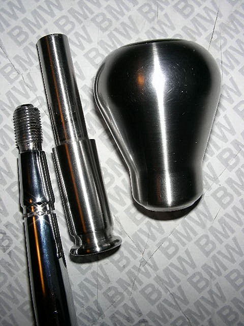

Here’s a short shifter project I’ll get around to installing eventually. It’s a Fidanza shifter with an extension/adaptor for the UUC ****. For my **** gripping style ball shifters are very uncomfortable; I have to have a flat top. The top of the **** will stand about an inch and three quarters higher than stock. I know that most short shifter shoppers want that stubby look and feel but I want leverage and a closer reach from the steering wheel. Some of the leverage will come from the hefty stainless steel perched up top; the **** and extension weighs one and a half pound alone. The shifter rod is an additional pound as well. The gentleman who made the extension did an extremely precise job on the fit. The tolerances between the **** and adaptor are so close it pops when the **** is pulled off.

Installed the custom Fidanza shifter combo and have a few comments now. Adding the extension reduced the overall short throw effect both as a function of distance and effort. However, the bend in the stick moved the shifting action closer inward negating hyperextension of my elbow going from 4th to 5th. Another change is solid behavior, no sloppier stock shifter wandering around.
Nice! Now you have me interested. My main complaint of the MCS gearbox is the 4-5 shift and I almost have to lean forwards to make it (I'm 6'4" so the seat is back pretty far). A bend in the shaft is just what I need.
Could you explain the setup a little more? I assume the Fidanza has a screw-on type connector and the adapter you had made converts it to the snap on type for the UUC (stock type) ****. Correct?
