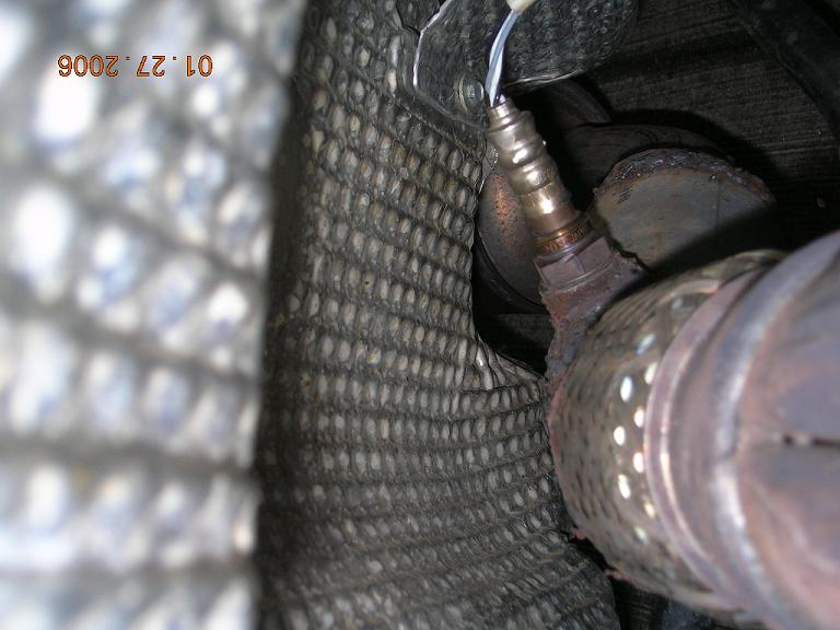

Kinda, the guy cut the pre cat right where it meets the flex line. Welded the new piece to the flex line, then right to the area under the bell or skirt looking part of the pre cat. I'll see if I can a picture of it on here tonight. Oh, I think the guy used 3" piece in there, it looks huge!

Old Jan 27, 2006 | 01:01 PM
  #47
sfjames2's Avatar
sfjames2
Joined: Apr 2004
Posts: 1,179
From: San Francisco Ca.
[ATTACH][ATTACH]Stock Header With No Pre Cat?-dscn1280.jpg[/ATTACH][/ATTACH]
there goes the pictures Dudes. I FINALLY FIGURED IT OUT!!!
James
Attached Thumbnails Stock Header With No Pre Cat?-dscn1277.jpg   Stock Header With No Pre Cat?-dscn1278.jpg

Here you go!

Cool...so what's your comment on this mod? Let's hear it....
