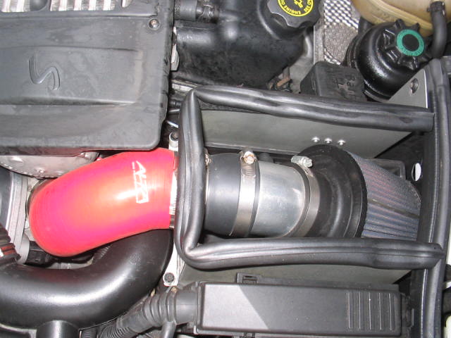

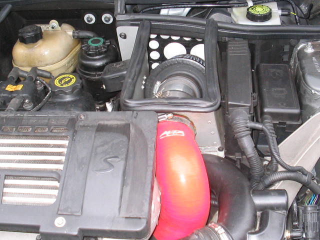

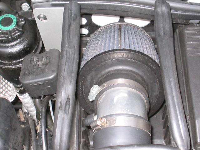

If it works anything like my DIY go for it!
Originally Posted by Holly's Mini
anyone?
I built my own for about $100.00. K&N filter, used Alta hose ( thanks to BigBrownDog), Randy Webb cowl mod., and salvaged 3" aluminum intake pipe from another intake, sheet aluminum salvaged from old PC case, rubber seal from chevy Biscayne firewall hood seal, SS hose clamps from hardware store.
Or you can get great results with the HAI < just do a search on HAI
Results and looks if that’s important to you go for the Alta.
Haven't seen anyone post about this intake before if you go for it give us your impressions.
