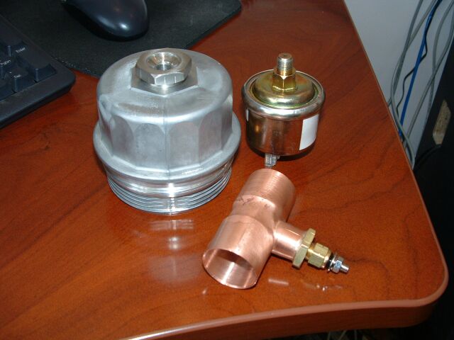

Are you sure you are putting the o-ring past all of the threads on the canister? It's a bit tough to see in this pic, but there is a groove for the o-ring, beyond the threads. You can also see that bevel-cut that makes getting started a pain:

Andy,
Your canister looks quite different from mine. The threaded portion may be identical...
I'll have to take it off again this weekend. What a mess!
I just don't need the O-ring to let go at LRP Thursday
