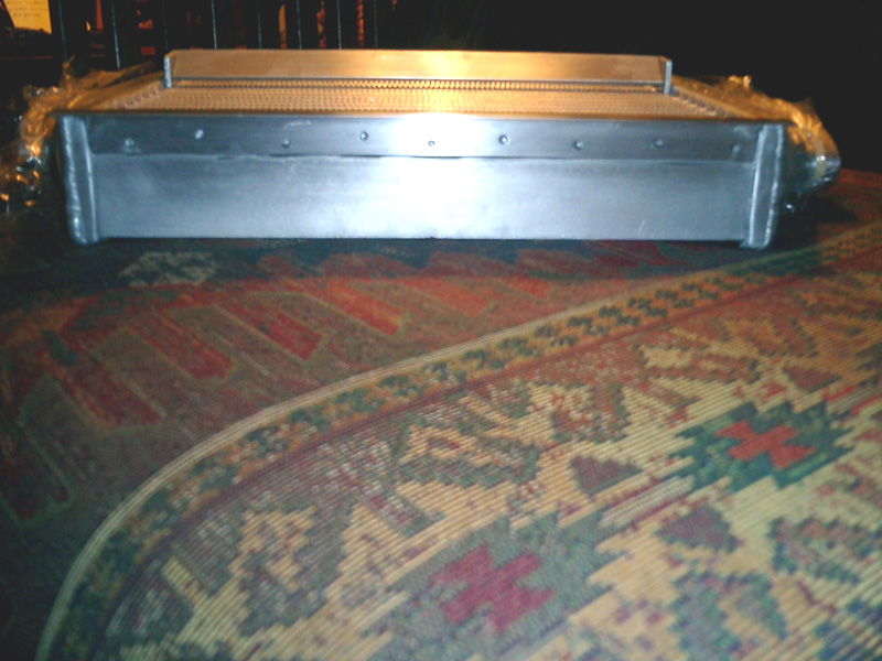

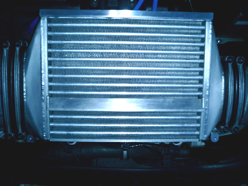

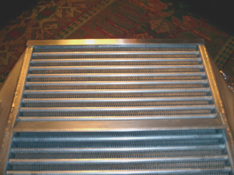

For those who don't know, the GRS utilizes a hood-mounted fiberglass piece with open cell foam strips to seal around the sides and rear of the unit when closed. Here's a photo of it not installed, after I layered the foam with some high temp silicone (Part 1), which allows it to remain contour-able, while preventing less air to seep through:
The foam on the sides compacts fairly well against the top of the GRS IC when the hood is closed. However, the rear portion does not sit atop the IC, by design. If so, it would cover the fins in that area, thus inhibiting downward flow in that area (not good). GRS's answer was to drape the rear foam strip just behind the back edge of the IC. I wasn't so keen on this approach upon seeing it, and the data-logging validated that it had some short-comings when compared to the stocker's ability to cool.
With the hood closed (before I made/installed the diverter - Part 2), I stuck an extended tape measure through the mailbox, and with minimal pressure it was easy to create a gap exposing space just over the spark plug wires. It didn't take much imagination to visualize what's happening at high speeds. While the driver and passenger side foam formed a nice seal, the rear sucked, and that is probably the most important one given that the air is rushing in from the front, straight toward the back...
So, the next mod was in order, and that was to create a flat surface for the rear foam strip to compress upon. Once again I was fortunate to have had the perfect size of aluminum angle to make this happen. After a few minutes of taking measurements, and about 10 minutes with a Dremel cutting wheel, I made something that should do the trick. I drilled several holes in it to aid in the adhesion process (good ole J-B Weld coming next). The photo below of it on the GRS IC has it taped into place just for the visual...
I'm still minus a nice camera, so I'm dorking around with a webcam, thus the low quality photos. I'm eye-balling another Canon - the 350D . Until then, crappy pictures...

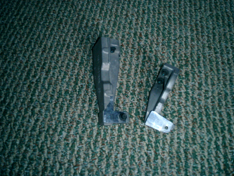

I noticed while removing the GRS IC that I no longer need the rear stock mounting points (photo attached). So, two good chunks of metal removed (I'm big on weight-reduction), also making for more room below the GRS, and easier access to the #1 spark plug wire. I filled those threaded holes with the same high-temp aluminized silicone.

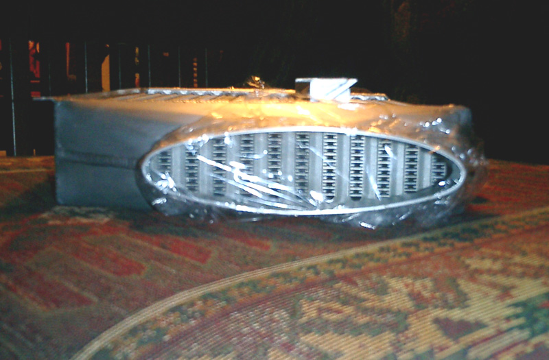

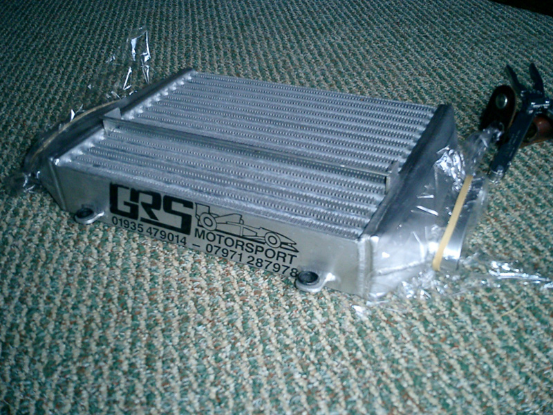

The J-B Weld did a fantastic job securing this piece to the GRS IC. It took a good 20 minutes to clean it up with some emery paper, and it turned-out quite nice. I shot some of that high-temp silicone in a couple small areas where the piece wasn't a perfect cut...
It will install it tomorrow. A few more photos...
