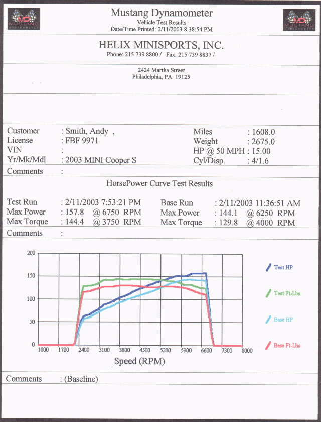

There have been lots of before and after dynos showing the effect of the pulley on an otherwise stock car. Here's mine for example:
I haven't seen any customer dynos showing the same test, but with the MTH Tuner file delivering "COOPER S ca. 200 BHP". That claim seems to indicate much larger gains than going from stock to 15% pulley.
