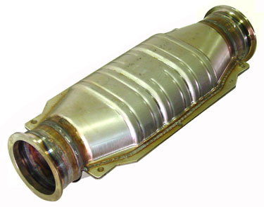

I'd look into replacing that cat with one like this:
http://www.atpturbo.com/Merchant2/me...egory_Code=BCS
jlm has one on his MCS with no codes, and I used the same for years on my VW GTI 1.8T without problems. Some manufacturers are using cats that are woefully inadequate at doing what cats do.

Thanks for the link Andy,
Minimania is sending the Ultrik with an "improved" cat, I want to give it a shot since it is a warranty replacement. I'll post if it fails and pay the $150 plus for your suggested replacement.
