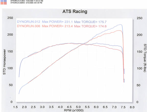

Originally Posted by TonyB
Thanks for the reply Randy. I totally understand the dyno being used as a tuning tool to evaluate modifications. I was under the belief, from your mule and jlm's rig, that right around 220 whp was the max that we can expect to see with the stock blower as the sole source of forced induction.
Then, in this thread, talking about the max whp w/o a turbo, we see 236... In trying to reconcile this delta (from 220), elevation came to mind.
Oh well, I guess just another example in why not to put much credence in comparing dyno plots of different cars, on different dynos, with different operators, equipment and techniques...
