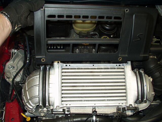

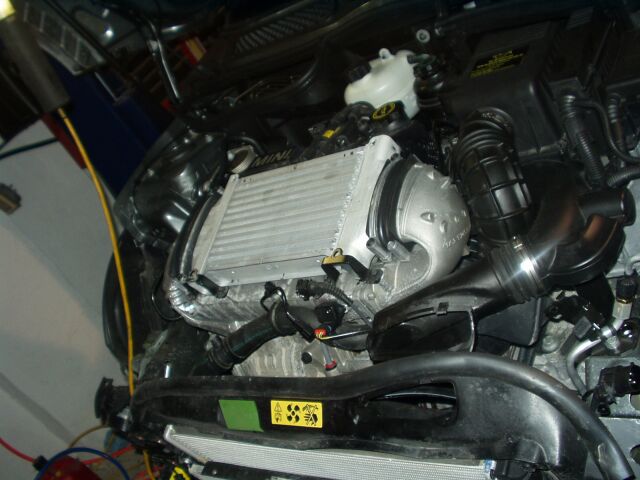

I didn't measure the heights of the brackets, but the '05 and '03 look the same to me:
'03:
'05:

OK, I spend a good 2 hours at the dealer in San Antonio looking at every single available MCS' hood scoop. There is a differences in height between samples in regards to the intercooler and the hood diverter. It is not model dependent, as I suspected, and the mechanic could not explain it. It can vary 1/2 inch up or down. Not sure how this is possible, but it is clear that it is not a design change.
Also, there are 3 different versions of the hood diverter. 02 to 03 have a rubbery soft hood diverter that has an angled flap that goes upwards and overlaps with the IC cover. 04 and 05 have a plastic hood diverter that has no angled flap. It does have two cutoffs at the edge close to the IC cover, but it does not touch it. 05 has a plastic hood diverter that is even shorter than the second version, in its distance to the IC cover. That means the gap is bigger. This third version is what is available for replacement at the part department, only.
This case is closed. thumbsup:

I found the reason the intercooler appears to be taller on some cars and just right on others, it’s the hood/bonnet latch adjustment .
