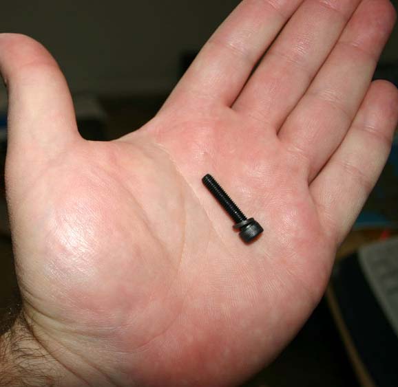

Common sense says a 4mm bolt doesn't take more than a few ft./lbs. of torque, let alone 80! Anyone that tries to torque one of these (this is the actual bolt off an Alta) to 80, has no common mechanical sense.
