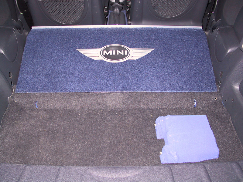

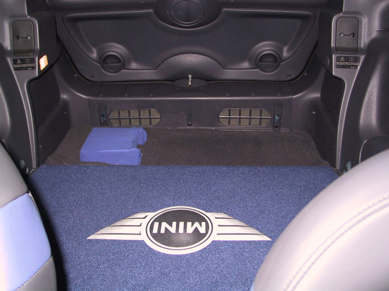

I just took these tonight to better show the battery situation...
Attached Thumbnails Straight through exhaust-sla-battery-1.jpg   Straight through exhaust-sla-battery-2.jpg
