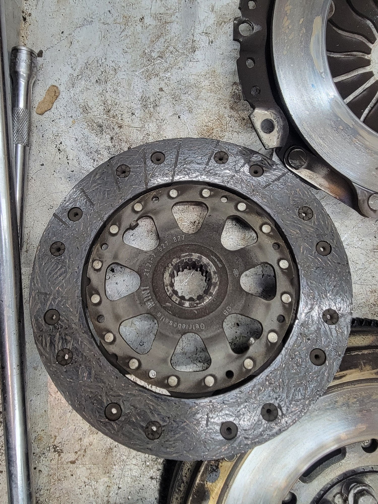

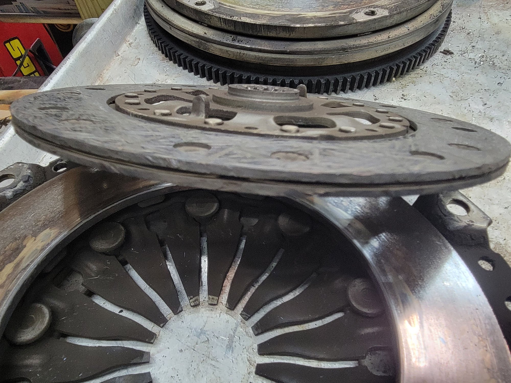

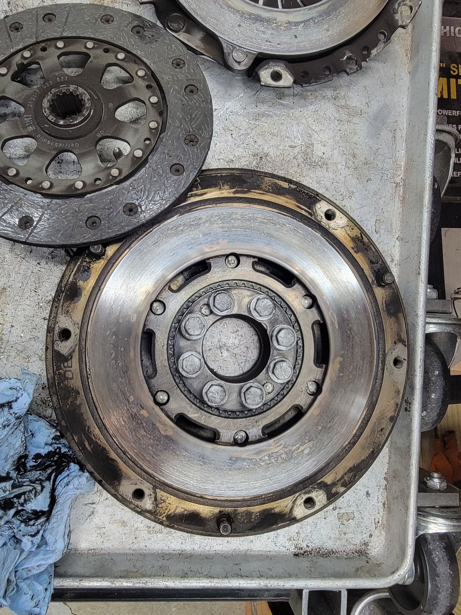

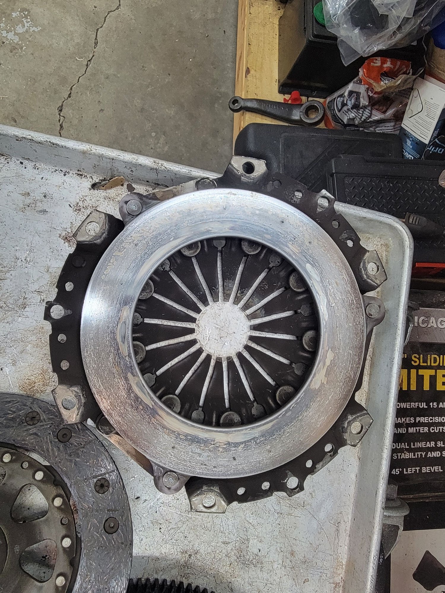

Here's what I'm working with: 06 MCS manual. 155k Minor mods, no racing, no track. Mostly just a DD.
Currently have the DM flywheel that looks to be in decent shape. I can buy a replacement LUK clutch kit for $120 on Amazon.
I had a light SM flywheel in my E39 and sounded like a tractor. I totally hated it. Don't want that again. Am I on the right track or should I be looking at something else?
Here's the thread covering what I'm working on : https://www.northamericanmotoring.co...ome-ideas.html
Here's what I just pulled out.

I posted this same response in your build thread:
My guess is that the noises you got from the single mass conversion are due to the light-weight version you went with. I have a ClutchMasters single mass in my R55, but I went with their steel version. The steel version is just about the same weight as the OEM dual mass, and I don't have any issues with noises that weren't there with the OEM dual mass piece.
In your case, and with your requirements and driving, I would get a new dual mass flywheel. Also, don't skimp and not replace the clutch disc and pressure plate. Considering the work involved in getting to it, its cheap insurance from having to redo the job in a coupe months.
I'll add here that the dual mass flywheel does have a service life. Looks like you (or previous owner) took care of the clutch, based on the condition of the disc. But the springs in the flywheel can wear out, and cause the flywheel to lose some of its shock and vibration absorbing properties. Again, cheap insurance when you consider what's involved in getting to it for replacement .
