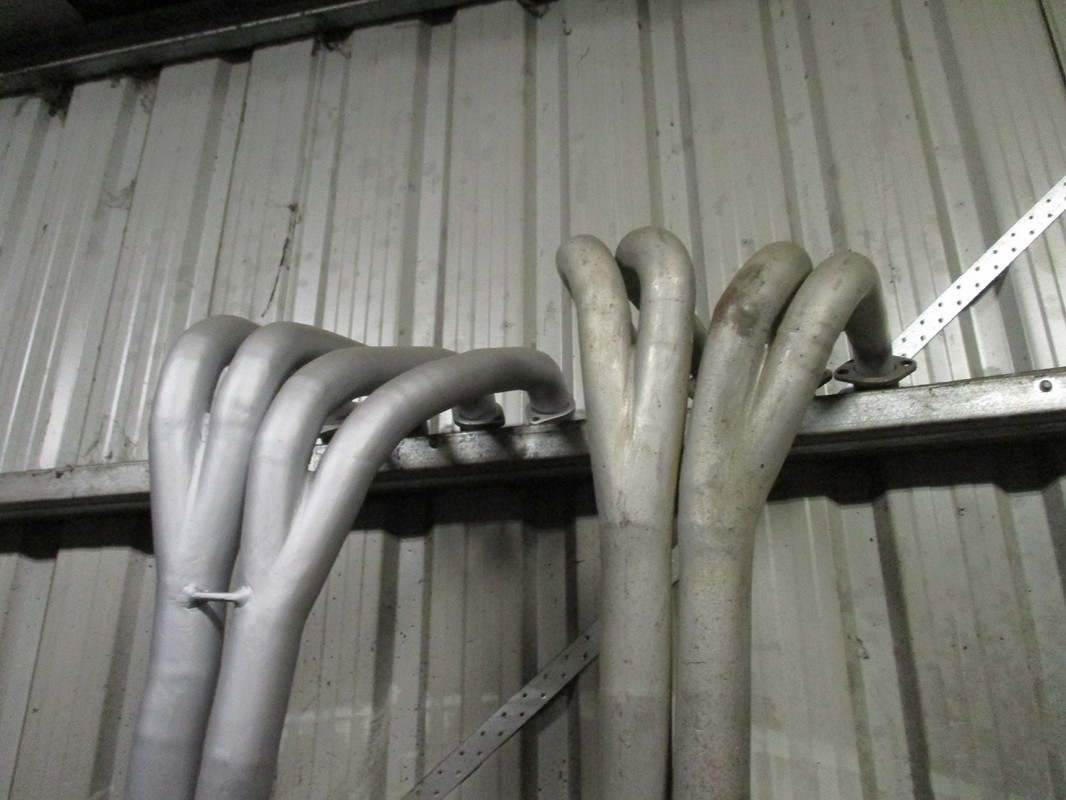

What you don't see much of, even on the most well known brands is mixers that look like this:
Because they take time. You cant just do a quick cut & weld. You can see a lot of joins there, the pipe on the inside however is perfectly smooth. Now go have a good look at the mixers on the header of the well known Scorpion 4-2-1. They are just stamped pieces with a bad shape. They might be helping to correct the volume thru the mixer (absolutely crucial!) but they are bad bad bad for airflow.
The main reason to install a set of headers isnt just the increase in HP at the top end, its more about liberating the engine to rev more freely <~~~ this is worth just as much as the top end HP increase. Just about the only system i've yet seen for supercharged mini's that has mixers worth a damn has been the RMW race pipe (not their shorty). Your going to see a dramatic improvement over stock by buying one of the Supersprint copies. The OBX & the Becker both are good buys & will work better than just about anything else for cheap. That style of 4-2-1 is exactly what the new gen mini should have had standard.
