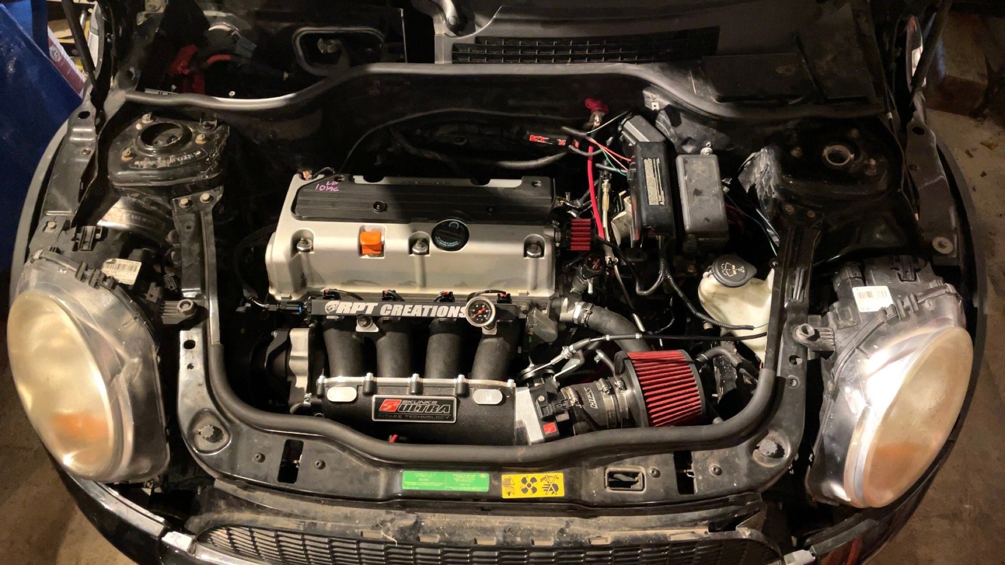

These guys have a prototype kit for a R56 swap, but no ETA on it from what it seems like. One guy did get his hands on one and it fits nice in the bay.

K24a with a freshly rebuilt k20z3 trans, hybrid racing no cut shifter box which is a super tight short shifter and feels great, skunk 2 ultra street manifold paired with their 70mm pro throttle body, rsx type s injectors and stock mini fuel pump for now and it’s got a Hondata kpro v4. NA for now cause it’s my daily driver but goals are to make MAX 350hp once I add a turbo. Not sure how much it makes since I haven’t been able to start it without the header but I can’t wait to drive it lol.

I’m just gonna use my Wagner inter cooler I got for it when it still had the stock engine. It’s a good but expensive intercooler so I’m def gonna use it and it bolts up to the stock location. Turbo manifold is the most difficult fitting part but most people just use a sidewinder manifold, you should see rptcreations r53 that thing is a scary beast🫣
