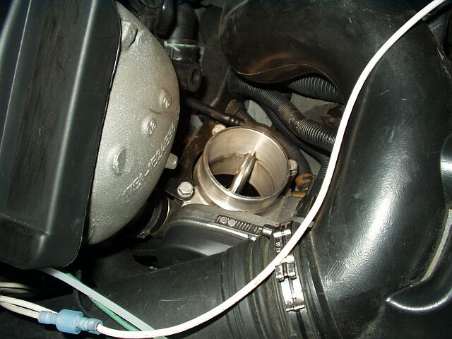

Interesting.
I was thinking about trying the zip-tied butterfly valve trick, but considering I have a customer's turbo Civic Si coupe (99-00) at the shop with a crankshaft that can be moved BY HAND after flooding the motor with too much boost too soon, I was kinda nervous about doing it. I know, our 1.6L motor is built up a good bit more to withstand the boost, whereas his was built for near 10.0:1 compression..... BUT STILL! I was told that there was a problem with the 02 model butterfly valves and they needed to be replaced - I was instructed that mine COULD be affected by this "recall," but most likely was not.
That's an interesting point you are making about the throttle body, Jdewey. Before I got the transmission back on (note to all - NEVER try to replace and reinstall an MCS tranny with the motor still in the car, no matter what our beloved Bentley manual says to do!!!), I did nick the cable connector that attaches to the throttle body - the only problem I have with considering that this incident puts the TB at fault is that the problem occurred prior to the R&R of the transmission.
Bottomline: What is a simple test to determine if the throttle body is not reading WOT? Now I wish I had my S-AFC II installed considering it has a reading on it that displays throttle percentage!! Furthermore, is this something that can be corrected considering it may not be opening fully, or replaced entirely? My guess would be to replace the unit, but then Lee at Century MINI and I will have to discuss how much that one will cost if it can't be done under warranty.......

I think I might agree with the idea that there might be a leak in the intake system. It would not offend me to say that the idea completely sucks either - it was engineered to! I just wanted to create a way for the filter to be located in the same general area that the aftermarket filters are without setting people back $200 or so. Problem is, the boost loss occurred prior to installation of this intake system, which is why I was recommended to get a new intake because the problem could have surrounded the idea that I was not getting enough air into the system, for some odd reason....
The bypass valve and slipping belt might be more appropriate gremlins causing this problem - I did, however, purchase the correct NAPA belt for the 19% reduction pulley, so what would cause the slipping belt and how can that be checked without having to go through the pulley installation process only to learn that may not be the correct "gremlin?"

you aren't getting any check engine light codes?
if you have a vacumm leak you will run lean at idle and that will usually throw a code super fast.
If you have no codes, then it is probably the by-pass valve. tie it in the full closed position (ie the lever is all the way out), this should clear your problem boost problem.
