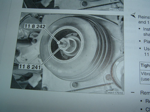

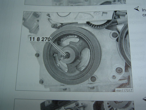

Here’s a how-to in PDF using OEM tools https://www.northamericanmotoring.co...light=bomboasy
The crankshaft bolt is 12X1.75X74, the extracting bolt grip size & pitch you have is correct. I recommend using a new OEM bolt when installing, there is a risk of bolt stretch on the original and the new bolt will have proper thread lock applied. If you intend on using the 12X1.75 bolt as a thread protector, the OEM tool is 100mm, and the pulley sleeve depth about another 36mm. The 6X1.0 OEM extractor bolt grip bolts are 65mm.
A holder tool can be omitted by placing in gear and having an assistant step hard on the brake. The OEM installation tool is worthwhile; I would imagine an alternative could be found (rather than using progressively shorter bolts which may gall the crankshaft threads), like those installers for power steering or alternator pulleys, but I haven’t looked.

Crankshaft threads are ~30mm deep, only ~23mm used by the pulley bolt.
Good idea on the installer tool, it doesn't require much torque if there is no friction at the contact surface, but it must be true.
Expensive is relative, I think they are compared to Snap-on (which are high to begin with) for instance, but well worth it for ease of use.
