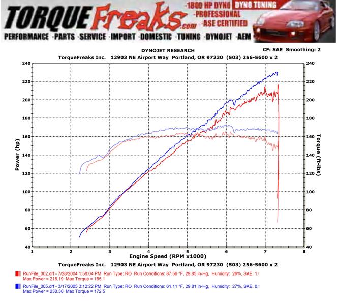

Well here goes. Feel like I'm about to walk into the Valley of Death. Did my dyno run, as planned on March 18th, and am reporting back now that I have the files. Let's see how this discussion goes.
Very nice gains over last July. WHP up to 230 from 216. Torque up to 173 from 165 with no drop off. Temp was 60-61 vs. 89 last July. I asked about the correction factor and they said the Dynojet did correct, but probably not completely for the 28 degree difference. Could bump the old numbers up a bit.
Relevant mods are the Madness header w/test pipe and the greater capacity water-to-air IC. Necessitated by addition of top-mounted oil cooler. Changed Borla Sport out for Borla Street so I don't spend all day on the side of the road with the blue lights flashing discussing decibel readings.
As to sound: About the same in loudness, which I like. Slightly different tone. Quieter when cruising (good ).
IC temps are incredibly lower. As reported earlier, am running about 22 degrees cooler everyday. Even better results on the track. Never crossed 130 at Portland Int'l Raceway on the 19th during very fast-paced fourth session (was running with 2 Porsches). Would usually see in the 150-160 range.
Oil temps are steady on street, 210-225. Just reached 260 in the last session when I was bumping the red line in a few spots.
Which reminds me, the car is running so strong that we upped the red line from 7250 to 7500. I believe the file from Oliver at Evotech also has a few other tweaks. George and I have been sitting on it for awhile and forget. We're checking on that. Anyway, even more power after the re-chip. Might have to spend more money for another dyno.

Good info..... looks like the HP you gained was from Reving the engine past stock redline. At stock redline your numbers are what we have been seeing with MCS's that have been heavily modified.

True, but what is interesting is that it isn't falling off like last July (red line 7250 then also). Torque stays flat and HP keeps climbing. Feels as though it can pull to 8 grand, not that I would take it there, due to reliability issues. Did feel comfortable going to 7500.
While at the track, the Rasmussen dealership Mini was there. They go to 8500. Engine is bored/stroked by race engine builder, plus all the usual goodies. They pulled 251 on the same dyno, so I feel pretty good.
