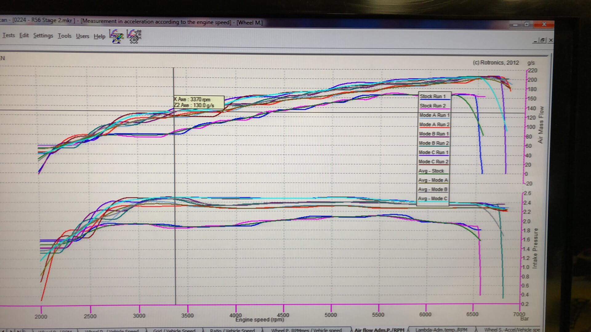

Hi,
Had my N18 JCW mapped to Manic Stage 2 today, car runs a Airtec Intercooler, scorpion decat and AEM. It produced healthy figures, drives well and pulls like a freight train, but on the dyno the power graph looked a bit strange. Stock and mode A are a nice smooth curve but then B and C seem to be inconsistent up top end?
Will be asking manic to see if they have any ideas but I was wondering if anyone had the same sort of thing or any ideas what it could be?
Car has no faults codes logged, it did have a code for a valvetronic fault in the history but I’ve owned the car over a year and it’s never thrown a check light.
Any ideas would be greatly appreciated.

Can you data log? Timing, A/F, IAT, rpm, not sure what else would help troubleshoot with your manic dealer.

Hi,
Yes it’s stock clutch, I will see if I can get the data log for the runs, they where recorded I just forgot to ask for them. But we did have a quick look through them and everything seemed to be where it should be in terms of boost, AFR etc.

I tend to wonder if you’re maxing the turbo out ! Before my high compression rebuild I had the same problem then I started running a 47mm turbo with meth !!

Bhp figures, removed the diverter valve today and seems fine but will fit the latest revised valve anyway

I agree with saying that your turbo is just maxed out. its just looks like the power is fluctuating. On Map A target boost is 18lbs which is easy for the S turbo to do. but on MAB B (20lbs) and Map C (21.5lbs) the S turbo has a hard time keeping up with that demand in the upper RPMS.

It’s a FJCW with JCW turbo.
Got some graphs of the air flow and intake pressure, couldn’t get AFR but everything seems fine with that.

I dont see any major inconsitencies.. looks fairly normal
