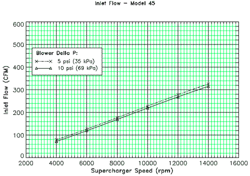

I've got too much time on my hands. I did a bit of search on the SC on our Mini to find some performance data. I have alluded to that our SC Mini is very fuel inefficient before, because it takes 10s of HP to spin the SC and in return, most of us get back just 10s of HP. So here are three graphs of the Eaton M45 supercharger. Anything concerning fluid dynamics and thermodynamics are no walk in the park for layman. So for what these are worth here they are:

lung capacity of the SC hog:
None of these graphs depicts increase boost with a reduction pulley.
