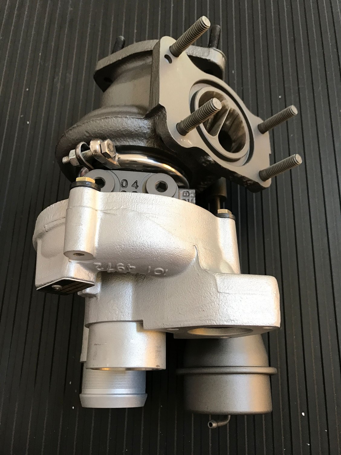

Car reduced power and lost boost after code poped up, did alot researches on P2885 and it seem like my turbo is gone, but wanna confirm with all Pro here to make sure I address right problem. In case its the turbo, Im thinking of get the k04 upgrade which Gpop sound like best for buck.
Anyone has the issue before please give me some idea and should I go with k04 Gpop and tune stage 4 or any other recommended brand.

G-pop rebuilt my JCW turbo. They are fast. I just installed it yesterday.

What did you find?

Turbo failure, and got the new one from G-pop too, with stage 3 Manic tune, its a real Monster
