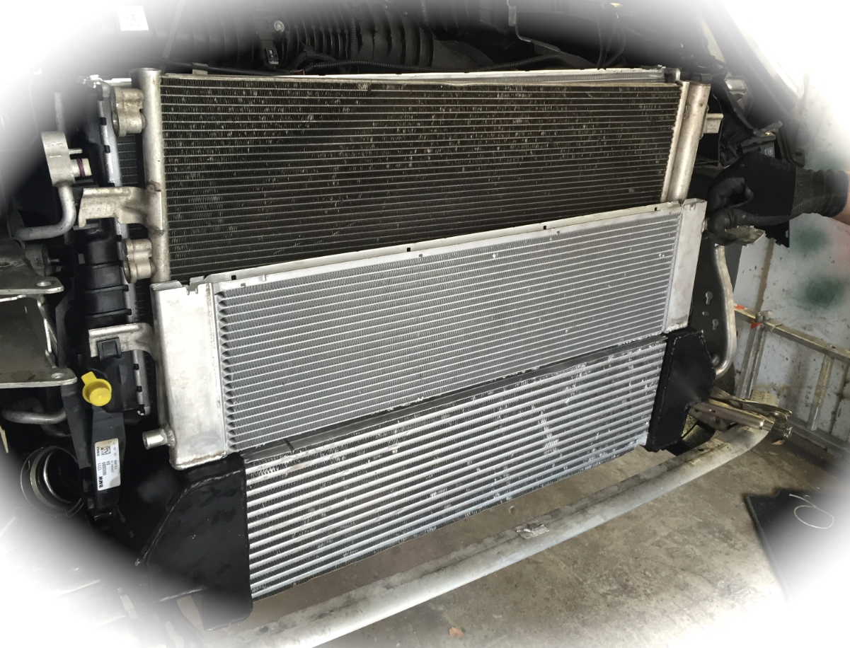

Cooling Kit
Cooling kit for MCS

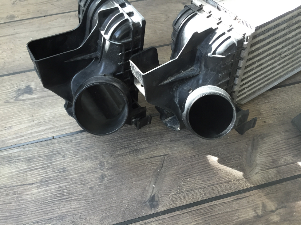

Cooper S standard frontend, note the airflow marks above the intercooler - good position
for remote radiator.
JCW 70 mm / Cooper S 60 mm charge air in/outlet - Its not only the core !
Attached Thumbnails Cooling Kit-bildschirmfoto-2017-04-01-um-13.59.08.png   Cooling Kit-img_2213.jpg

So is the remote radiator (i.e.- above the intercooler) just for increased cooling system capacity of the engine coolant? Basically kind of like moving from a 1 or 2 row radiator core up to a 3-core unit for additional heat removal, correct?
Sorry for being a bit confused on the concept, just trying to wrap my old-school hot-rod brain around your upgrade. The intercooler upgrade I am good with, FWIW.
Old Apr 12, 2017 | 12:08 AM
Clutch Wotan's Avatar
Clutch Wotan
Joined: Sep 2014
Posts: 662
Likes: 158
From: Germany Hamburg
The approach is a PLug & Play Kit for increased power over 300 HP
The Cooper/Cooper S intercooler is changed to the +-25% more efficient JCW one, as the core height is higher you have to use the JCW Radiator as well, which has two additional ports for the remote version, the Cooper S don't have.
In order to make full use of the improved intercooler, you also have to use wider diameter charges hoses, for that i developed the following kit parts
1-Inlet flex - quickfit adaptor
2-Charge tube complete ( with alternative water injection).
So now you have installed the JCW Intercooler. In order to compensate the smaller radiator core, we choose a additional front mount radiator.
As the cooling of the turbo, is water and oil based, both regulated via the water temperature, it is crucial, why would MINI consider this with their expensive wheels house additional cooling ?
The whole issue makes only sense for F56 with over 270 HP and ECU tune, for the normal usage "Burger box" etc you fine with the factory system. additional intercoolers, except some custom versions, makes no sense in term of prices
and performance, as the JCW 13 rows is the best !

Important as well is obviously the airflow and its direction, shrouds and aero parts guarantee a free flow under the car, and through the motor compartment.
Old Apr 12, 2017 | 10:46 AM
WhatV8's Avatar
WhatV8
Joined: Oct 2016
Posts: 533
Likes: 123
From: Streamwood, IL
Ok, I have a clearer picture of what you have put together.
The only thing I question is placing the auxiliary radiator directly in front of the main radiator. All the heat rejected out of the aux radiator goes right into the main radiator, which in turn would reduce the overall efficiency of the system. I have a feeling this is the main reason the aux radiator in the JCW is in the wheelhouse, so it is in a different airflow path. Not sure if you are indeed getting the 'bang for the buck' with that aux radiator setup and it might just be enough to simply upgrade to the JCW radiator alone if you are not going for much over the 300hp mark??
