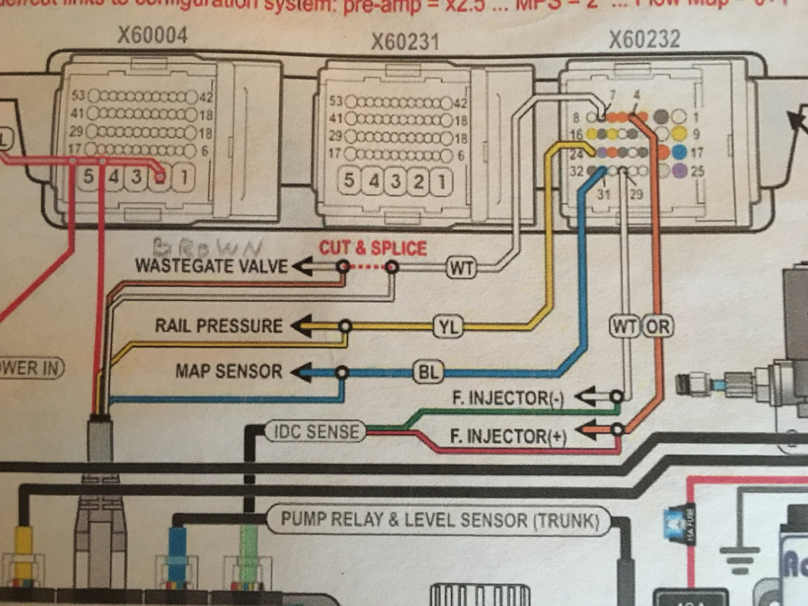

Does any one have a photo of how they wired up the wastegate wire! I know it' says cut/splices together but for some reason ' am super confused with the step ! I've emailed Jeff an he sent me a email right back . I think am just having a blonde monument an would like a few photos !!!! Any out there ?.

For the waste gate:
Step 1: Cut the correct white wire - pin 7 on the x60232 connector.
Step 2: Solder the white wire from the Aquamist ECU cable to the connector end of the white wire that you cut in step 1.
Step 3: Solder the brown wire from the Aquamist ECU cable to the other end of the white wire that you cut in step 1.

No it makes it crystal clear ! When I was talking with Jeff I felt like a deer in headlights ! I'm a pretty mechanical guy! An I was getting kind of frustrated over the hole deal. I did come across one of the forms you started and I was going to private message you but then I realize it was from 08 I believe it was '
How far down from the plug did you cut it?

I think about 3-4 inches. Not too far so that the splice would still be under the plastic cover to the ECU.
