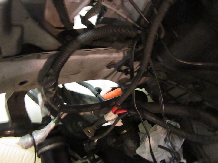

Originally Posted by BigBoost
And would you be able to get a few photo of ever thing
The first three pics in my "garage" show the tank, glovebox, and gauge (the one on top). Here's three more showing the Fast Acting Valve mounted in the battery compartment, a harness "loom" used to protect the wires and hose under the car (not furnished with the kit but highly recommended. I had to repair mine --- it's the harness with tape), and a shot of three wires going to the ECU.
Note the engine is not in the car and things aren't quite where they would normally be. Also, my pics don't show where the harness / hose goes through the chassis / dashboard. I used grommets (also not included in the kit) to keep stuff away from sharp edges. Both looms and grommets are readily available at most hardware stores. The size and quantity will depend on where you choose to route things. ECU wiring will be different if you decide to connect the "fail safe" feature --- mine isn't connected. All wire connectors are included with schematics, pics, and detailed descriptions --- hard to go wrong.
