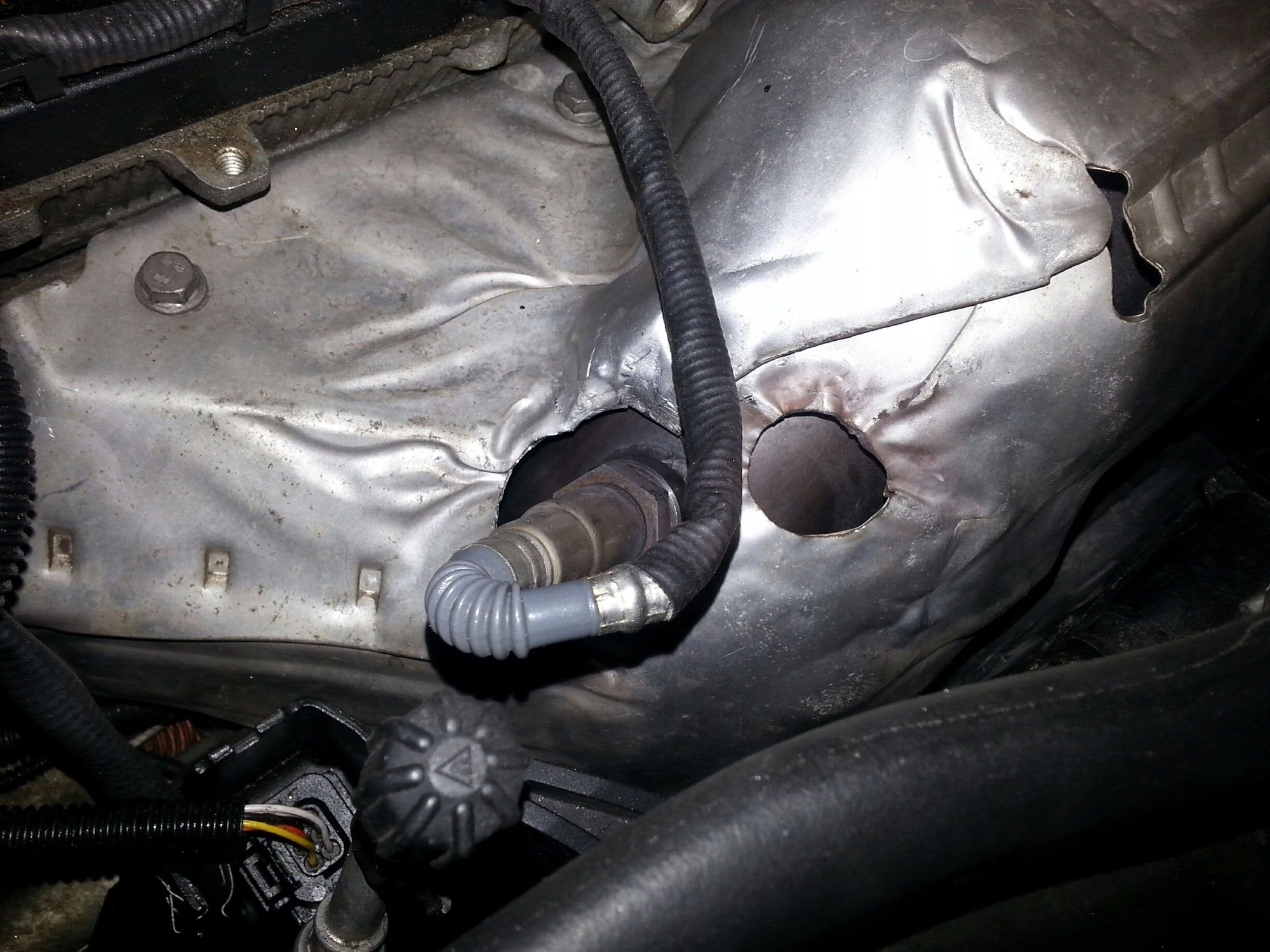

Originally Posted by dstar26t
I have an ATP downpipe too and had the opposite experience. I thought it was well made and the v-bands were flush. They told me the heat shields wouldn't fit but I figured I could get around that. The top heat shield fit perfectly but the bottom did not so I left it off and used some DEI Titanium exhaust wrap to protect the plastic radiator fans. The turbo exhaust housing flange nut closest to the front of the car was difficult to get tight and will be difficult to remove when the time comes.
See album here
Is that pic of the upper shield before or after the install? My o2 hole was several inches off.....
Old Jan 13, 2016 | 11:00 AM
dstar26t's Avatar
dstar26t
Joined: Oct 2009
Posts: 54
That was after the install, it fit perfect, I was amazed. Maybe this was a newer and therefore revised downpipe. ATP told me neither heat shield would fit so I wrapped it before even thinking about installing it. The ATP rep also mentioned they were working on a revision to accommodate the heat shields but it hadn't happened yet. I bought it new in June 2015 and had that correspondence then. I wanted to wait until after my annual PA inspection (December) to install it just in case it didn't pass. I have an accessport that cancels the O2 DTCs but I'm not sure if there's a ready code associated and didn't want to have to swap it back to stock that early if it failed.

Here's how far off the o2 hole was
