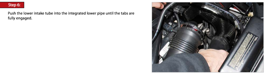

So, the hardest part to install was the lower pipe. Obviously the Carbon has no flex compared to what the JCW/S intake has, so they slip on easily, but with the Carbon, it is extremely tight, at least for me to slip it on.
In the guide, it shows a hand just slipping the lower intake tube into the lower pipe, well, this was so complicated and tight, I could not get it to go in all the way. What I had to do was take off the entire lower pipe and the box, and do it outside the engine bay where I had more leverage. Then when I had to put it back in, if you've done it before, the lower pipe has to be kind of spun back into place because of the way it bends, so that wasn't bad. Lock it in place and you're golden, but this did take some effort. I cringe thinking how it'll be trying to disconnect the two....

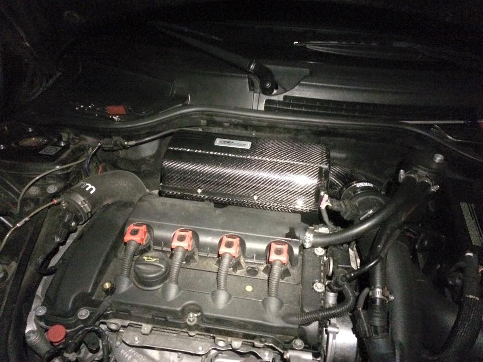

Engine bay shot.
Good luck everyone everybody, and those that have this intake, enjoy it's beauty.
