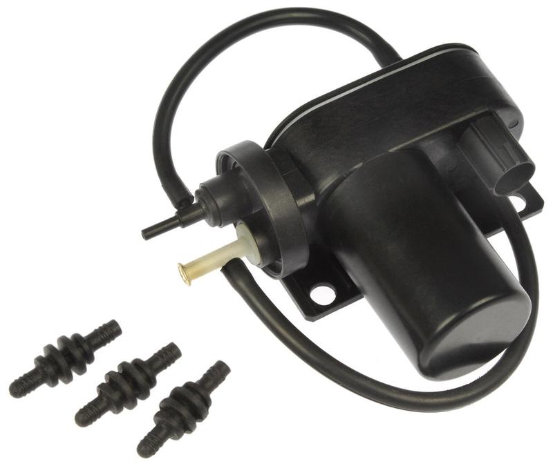

I wanted to reach out to the community to see how many people have had an issue with or found an alternative to their Vacuum Pump. I begin my journey here thinking I had the "Death Rattle" but quickly learned upon disassembly that my Vacuum Pump was failing, thus pumping oil into the vacuum reservoir and anywhere else connected. The vacuum hose had become oil saturated and thus came loose giving me drips of oil on the shop floor as an indication other than the noise it was making.
So being that I am in the beginning of this quest to remove this pump, I am thinking my alternative is to use an expansion plug in the head to not only block the port but also close out the oil port. If this doesn't work, then I will machine a close-out plate to work. I will also make a vacuum tank from PVC pipe with a 1/4" barb fitting in the top for the brakes and another fitting to go to the wastegate vacuum reservoir in the stock location. Using a GM Check valve inline to the main reservoir should keep the pump from working too hard. The Dorman 904-214 pump is what is used on my F-350 Dually and has been in service for over a year with no issues. This pump has an internal switch, so wiring is easy.
Any thoughts on this mod? I just cannot worry about a catastrophic engine failure with the amount of road miles I travel each month. Having a system like this I see as a benefit by having replacement parts easy to get and for a fraction of buying a replacement OEM part.

Yes it worked and I have since removed the aux vacuum pump as it is not needed.
You can call me if you need more answers. Maybe there is a machine shop willing to make the pump delete part. I do not have the time to make another one as I am traveling too much these days.

My apologies for not keeping up with this thread. It has been a year and since, I have found the aux vacuum pump is simply unnecessary. I am sure if you were autocrossing or driving on the track it might be necessary to keep enough vacuum but in my very "spirited" driving on Deal's Gap it was not needed.
