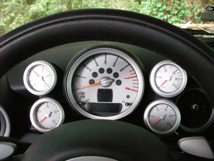

I added an oil temperature sensor and a gauge as well as a boost/vacuum, water temperature and oil pressure gauges.

Nice setup! I only have vacuum/boost right now, really want water and oil temp. Just a matter of installing them. After doing 3 or more gauge installs on 5 vehicles I'm pretty burnt...
