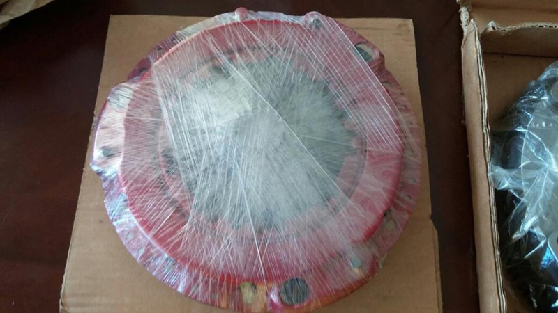

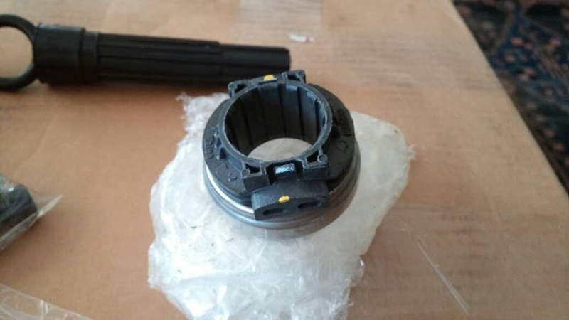

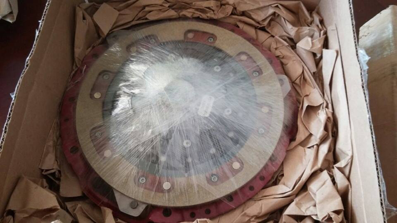

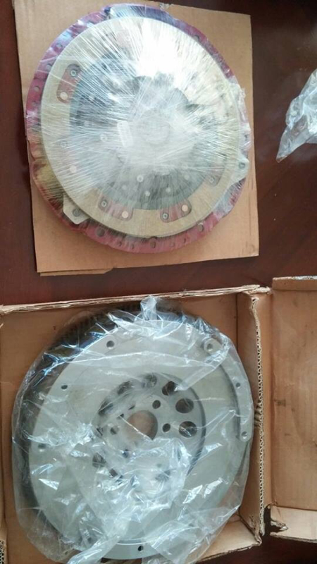

Father about 21'000 fun filled miles with my 2013 Mini Cooper S R56 my clutch decided to give up on me. I have full bolt ons on my mini, meth injection and Manic stage 2 tune. Here are some pics of the fried clutch and DMF.
After looking at all of the aftermarket clutch kits I decided on the JMTC stage 3 clutch with a 21lb single mass flywheel. Arric was amazing at helping me pick the best kit for my current and future mods. The clutch kit looked and felt very durable and oozed quality compared to the stock components.
Everything came well packaged and nothing was damaged or missing. I've attached a few pics of the kit.
