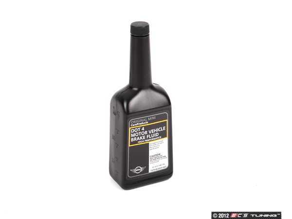

Here is the MINI Factory fluid :
http://www.ecstuning.com/Search/SiteSearch/81220146735/
